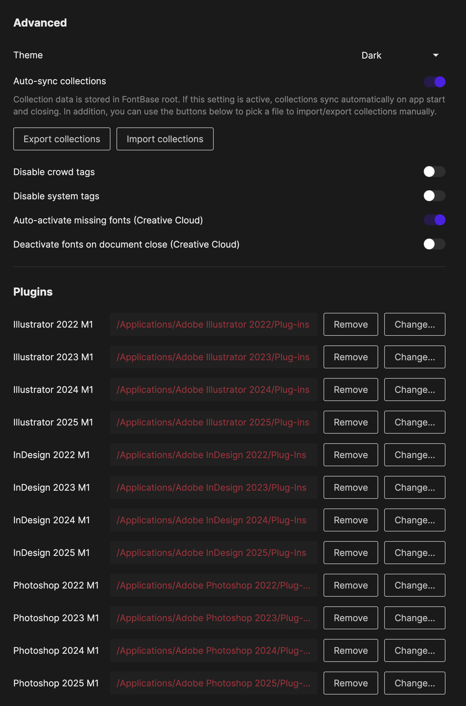

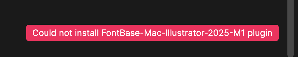

Hello again @kmhdesign :folded_hands:
What happens when you try to install the plugins on the new system using the Settings page without copying the files manually?
Maybe im missing something? I thought they were installed automatically?
the only options under settings is (it shows me the file path) then ‘REMOVE’ or ‘CHANGE’.
here’s some screen captures:
(upload://AfnWdK5DxuVwuqIzEow0SRDBkPt.png)
(upload://wyIA5V8459EOm8dRQFH02mbOwL5.png)
Screenshot 2025-06-13 at 12.18.23 PM|330x500
Screenshot 2025-06-13 at 12.17.55 PM|690x132
Thank you for the quick reply @kmhdesign :folded_hands:
They should install automatically, yes, unless there are some issues with the OS, for example permission settings. I’ll DM you the plugin files - would it be possible for you to copy them into the respective Plug-Ins folders and see if that would help?
Hello again @kmhdesign, glad replacing the plugins manually the trick :folded_hands:
Given that nothing within FontBase changed, nor did the plugin files, it seems that the cause was probably related to FontBase not being able to access the required CC app plugin folders (could be limited by the OS, user read/write rights, folder settings etc).
