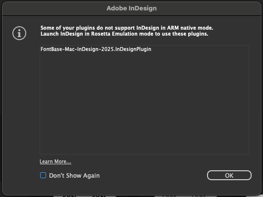

I’m having the same problem with InDesign 2025 on my MacBook Pro M4 Max. FontBase won’t work unless I check Rosetta on the InDesign app, but then I can’t add file information. I have no problems on Photoshop and Illustrator; just InDesign. Apparently I need the InDesign plug-in file. Please send it my way. Thank you.
Hello Timothy, thank you for your post :pray:
Could you please check if your InDesign’s Plug-Ins folder already contains a FontBase Plugin?
Also, what exactly do you mean by “FontBase won’t work”?
There is a plug-in file in my InDesign folder as shown in the attachment called Plug-ins folder.png. However, when I uncheck Rosetta and boot, I get a warning that shows as FontBase warning on boot-no Rosetta.png as shown in the other attachment.
Tim

Apple just did an upgrade on the Sequoia OS and I’m once again getting the Rosetta warning.
Screenshot 2025-05-20 at 7.33.56 AM

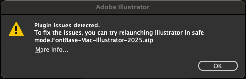

Hi Yuriy, you sent me a new plug-in last time and I don’t have one from you for this time. Now Illustrator is giving me this error message:
Illustrator screenshot 2025-05-21 at 5.17.23 PM
