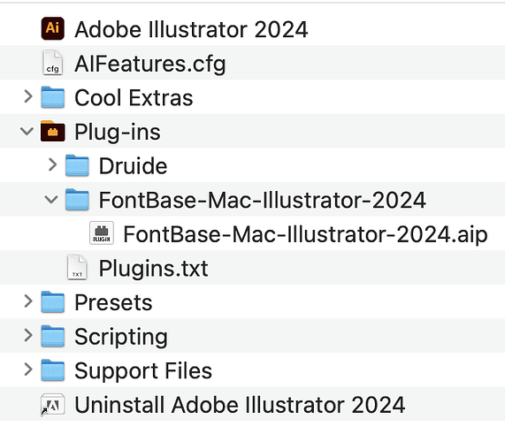

Would it be possible to check if the Illustrator 2024 plugin is installed correctly? The correct path should be displayed in the respective field in the Settings page and the FontBase plugin folder should be present when viewing Illustrator 2024’s Plug-Ins folder via a file manager.
If it’s already there and everything seems to be in order, could you please try to remove to FontBase plugin and re-install it from the Settings page?

Strangely, FontBase was installed outside the Illustrator plugins folder, at the same level as Illustrator. I’ve reinstalled FB in the Illustrator plugins folder and everything works normally. Thanks for your help.
