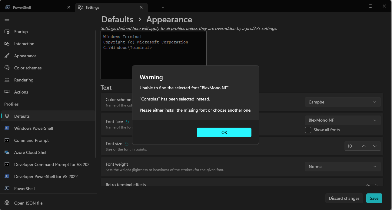

I have recently upgraded my Windows 11 installation to 22H2 and my apps cannot find the activated font. What am I doing wrong?

Deactivating and reactivating FontBase and restarting the affected apps doesn’t help, it’s like this for the majority of apps where I prefer to use custom font.
I have since noticed that this problem is present after a reboot but I can use the font if I do not reboot for an extended period (not sure how long).
