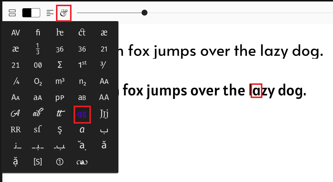

See attached screenshot with an example of stylistic alternates.
fontsalt

The OpenType Features button at the top near the Font Size slider is what you’re looking for.
As with other style changes, if you have no fonts selected, the changes will be applied to all the fonts you view, but if you have any fonts selected when changing this option, then the respective OpenType features will only be toggled for those selected fonts.

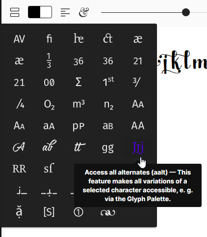

In the attached screenshot below, you can see an example of character ‘c’ for which there are two additional ‘Access all alternates’ (aalt):

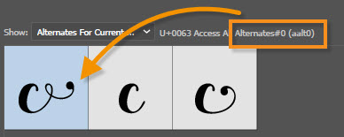

In Fontbase, when selecting ‘Acces all alternates’:

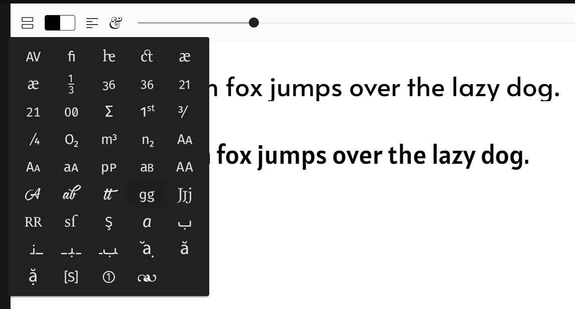

salt-3
I currently only am able to see the first ‘aalt0’:
salt-4
How could I view all available alternates?
